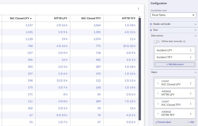

Adding an additional couple of screenshots to show what I have - these are all built directly from the Incident Table
Now when I go to add an additional Data Source to Select my Formula Indicator - I only see Tables, no Indicators:
Thank you for any nudges into a new direction!!!
@olgaredkina
Desired outcome (which is currently built with all PA Indicators and collection jobs)

Thanks @olgaredkina
Thank you for the feedback and information.  The challenge I have, which is why I have attempted to move away from full indicators as the solution is the ability to collect the specific data desired.
As our fiscal year started last week - when we are doing the comparison of Last Fiscal Year to This Fiscal Year
When I use indicators  I am not able to use the same "last fiscal year" selection criteria as I can from the table.
I am asked to compare the last fiscal year for the same amount of time that has passed in this fiscal year.
On the table I can use the conditions of:
Closed on Last Fiscal year
and
Closed relative before 365 days ago
When I attempt to use this in an Indicator - it doesn't work correctly.
Again, Thanks for the feedback.  I will consider my options and see what happens!
