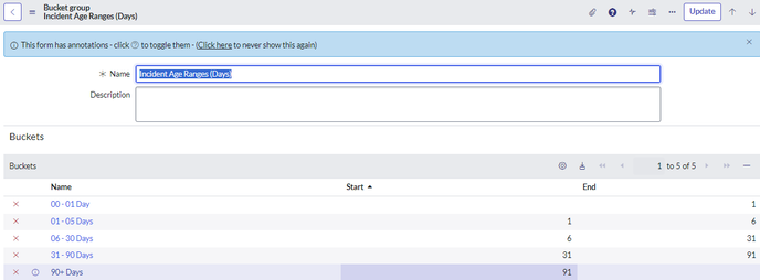

Instead of predicting precision ... "I need a bucket for 1,2,3,4,5,6,7,8,9 ++ ", take inspiration from the AGE buckets.
Age buckets are ranges, with the OOB final range being "90 or above"
ReAssignment and ReOpen don't need precision.  Its EASY for stakeholders to agree on comfortable vs uncomfortable ranges.
0-2 Reassignments?   That's fine
3-5 Reassignments?  Concerning!
6+ Reassignments?   What the absolute hell is going on here anyway?!
See?  At a certain point you don't care if its 6, 8, or 80.  At that point its "just too f---ing many".
Same story for re-opens.

I already proposed this, however team wants to see actual numbers, not 'bucketed list'. Same way they currently see in general reports. Any other solution without using buckets?
Wait... the whole point of buckets is to have a breakdown.
Are they really trying to break them down by DISTINCT counts?
Like is someone literally graphing "Incidents with 4 reassignments" as a completely different thing than "Incidents with 5 reassignments"?
You can build reassignment metrics without them being a BREAKDOWN
They are graphing by increments of one, but I will use buckets and explain why this method is more effective and how important it is to have a plan to reduce the count. Thank you for your assistance.
