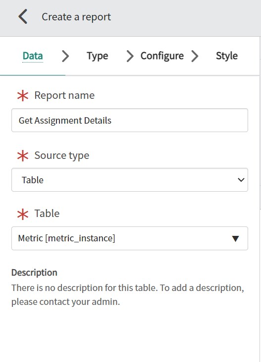

Hi, I'm trying to find out if there is a way to extract the report that shows all assignment groups the ticket passed through?
I managed to do it with the "metric_instance" table but I would like the TASK information
Has anyone done this? can you help me?
Thanks.

Metrics is the best friend here in order to get the data you are looking for.
For example: OOB there is a metric on Incident table for Assignment Group field which you can refer and build your own for a different table if you need.
OOB Metric Link for Incident Table:
https://instance.service-now.com/nav_to.do?uri=metric_definition.do?sys_id=39d43745c0a808ae0062603b77018b90
Replace "instance' with your instance name. Attaching the screenshot as well for reference:
You can build a Report using this metrics and get the task Info as well:
Result: This gives you info about the ticket as well when you group it by ID.
