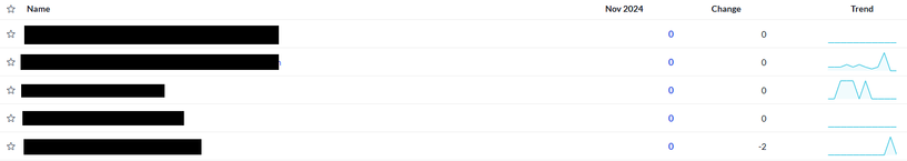

AndersBGS
Hi @schmidt4081 ,
If you have performance analytics installed, you can create a some PA to capture the utilization of catalog items. This will not only show the once that have never been used but also those that might only have been utilized 1 or 2 times. example shown below where I look at utilization on monthly basis:
best regards
Anders
