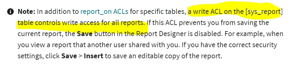

You can restrict creation of report on certain table by use of report_on ACL. Additionally, you can also restrict update on report by creating a write ACL on sys_report table.find_real_file.png
Refer doc link as well once.
