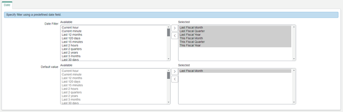

Using the Solution:
In your Dashboard, select Interactive Filter, and choose the Date one.
In the interactive filter, you will see the new fiscal period options available in the select list for Dates:
