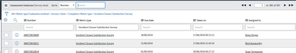

‎09-04-2018 02:04 PM
Hello Michael,
I tried using this table, but it didnt give me exactly what I needed see below
When i used the Metric table it gave me the below (which enables me to see the String Value) for comments and Satisfaction
I dont seem to get this on the Assessment table?
‎09-04-2018 02:22 PM
‎09-04-2018 02:55 PM
Exactly what I wanted... Thank you ever so much
