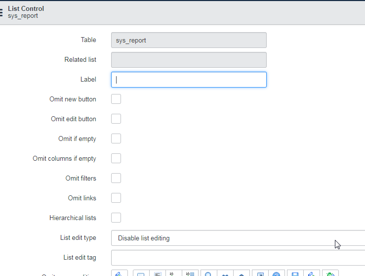

Hello, if something happens where I need to update the report owner / creator, how would I go about doing this?
My end goal is changing who has overall rights to the report outside of report_admin or admin. The new report owner would have the report show up in their "My Reports" and be able to edit / save edits as if they just made the report today.
What was mentioned in previous Community posts was changing the User field on the report, but as others mentioned, this will only change who the report is shared with, not who can actually edit it.
I noticed the created_by_user field, but it is currently read-only on the list level. The UI Policy to make reporting fields read-only doens't mention this particular field. If I try to change it from the report's file properties, nothing really seems to happen either.
9 REPLIES 9
Shane J
Check the List Control on the Report list, it seems to have editing turned off OOTB.
Thanks! I'm hoping I can get around having to go this far. If this is needed, I may just have to add that field to the report form itself (the form viewed from the sys_reports table, not the whole creation process wizard), and go from there with ACLs and whatnot.
