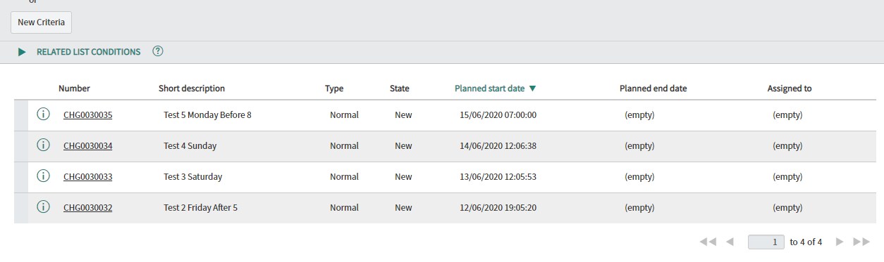

Hi Amit,
I've not watched the video for a while, just tried it on my PDI
I've created 6 test changes with different planned start date:
  • Friday before 5PM
  • Friday after 5PM
  • Saturday
  • Sunfay
  • Monday before 8AM
  • Monday after 8AM
I then have the report condition set as:
Which is giving me these results:
So the change before 5PM Friday and the change After 8AM Monday do not appear.  So it looks like you can get what your looking for with standard reporting - you may just need to fine tune the filter conditions further to meet what you need.
I did notice some inconsistency with the available options on the relative operator.  As you can see in the first and third of the OR conditions I could only select 'before' but on the middle condition it did show the option for 'on or before'.  Not sure what is causing this.  Might need to reach out the SN on that one.
