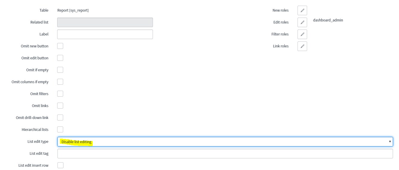

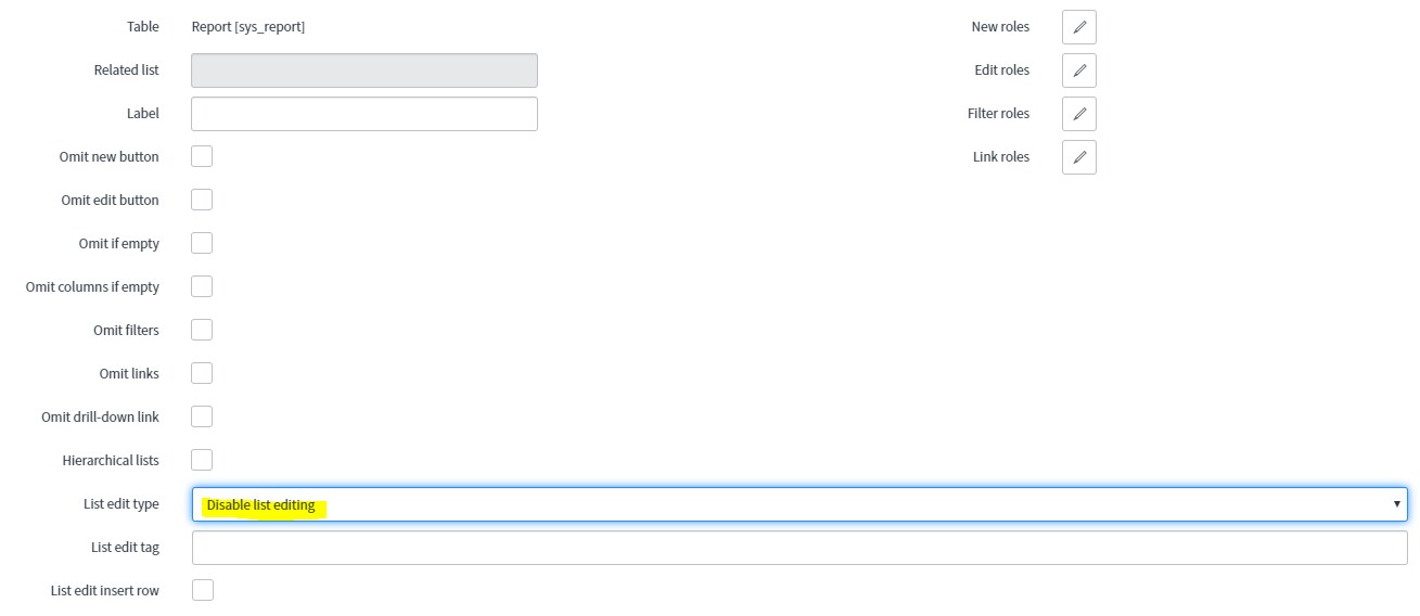

This question has arisen because I have many tasks where it would be very helpful if I enabled list-view editing for the Report [sys_report] table. By default, list-view editing is disabled on this table, though I have not been able to find any documentation on this restriction or why it was done.
QUESTION: What necessitated this list-view edit restriction on the Report [sys_report] table? As I'm sure there is a good reason, and I don't want to make more problems than I resolve by disabling this restriction.

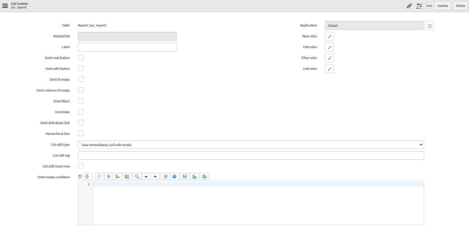

To Enable List-View Editing:
In the List Control menu for the Reports [sys_report] table, change the List edit type setting to Save immediately (cell edit mode). Save the settings.

I also see in the List Control for this table that list editing has been disabled. Simply toggling that value to "Save immediately (cell edit mode)" turned on list-view editing.
So, I guess the best method would be to combine this List Control on/off toggle with an ACL like you mentioned to enable list-view editing only for report_admins and admins.
