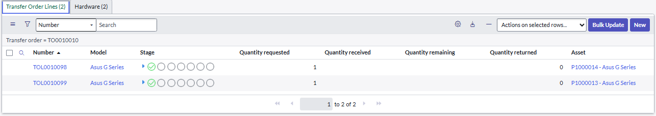

I have implemented the Bulk Assets Transfer Order Line.

Testing.
1. Go to transfer order > Click on NEW button. > Create a new Transfer order.
2. Navigate to Custom table in Related list within Transfer order form. Click on edit button add your assets into list.
3.  Select the added Assets  and click on Custom Ui button.
4. Check the transfer order line.
