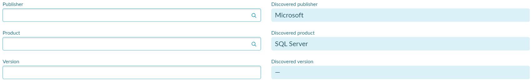

We have a few discovery models that have been manually normalized and would like them reverted back so that they can be picked up by the daily normalization job. It's my understanding that you can't use the "Revert" button method on discovery models that were normalized by pattern rules or manually. I have seen mention of this being done with a script though. I'm looking for additional information on this method or an alternative method for getting these reverted. Thank you for any information you can provide.

Thanks as always for the helpful information. Just so I'm understanding, the discovery model fields for Publisher, Product, and Version should be blank (see picture) in order for the normalization suggestions to generate?

Hi @ClayB,
they you have to manually normalize these Discovery Models with right 'norm_publisher' field and rest of the fields (norm_product and norm_version) as EMPTY and wait for suggestions to be generated.
In my opinion, however, it is a matter of luck whether your discovery model can be normalized exactly. You should be aware that with the settings mentioned, you will have to accept a greater loss of data quality and that installations cannot be assigned correctly until normalization is completed.
