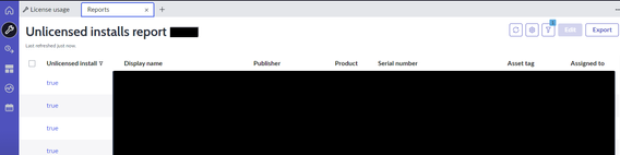

Hi @DominionA007,
[samp_product_result] table is for reconciliation results at the software product level. I suggest you use the software installations table [cmdb_sam_sw_install], you can filter the results to show the "Unlicensed install = true".  Then edit the columns to include the following: Product result > Product, Publisher, Installed on > Serial number, Installed on > Asset tag, Installed on > Assigned to.
Note that if you check the "Reconciliation result" per Publisher, there is a summary that shows you both the Software model statistics" and "Progress indicators (this is where you would see the "Unlicensed installs" as well).
