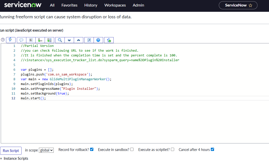

After spending quite a bit of time searching the forum for answers, I’m reaching out for help.
I installed a Yokohama PDI, activated SAM Pro with demo data, and then upgraded the instance to Zurich. After the upgrade, I attempted to install the “Software Asset Management Playbooks and Guided Setups” plugin, but it does not appear under System Applications.
I found a community post where a script helped others install the missing SAM Workspace, but unfortunately the script did not work for me. (screenshot attached)
Solved: Re: Missing SAM Workspace Plugin in PDI: Xanadu Re... - ServiceNow Community
At this point, I’m looking for guidance on how to successfully install or enable the Software Asset Workspace in my PDI.
Thank you in advance for any help!
08-10-2026 08:22 PM
same, after installing the sn_sam_workspace , it didnt appear
i ran a repair and itworks
02-05-2026 06:38 PM
You need to install :Software Asset Management Playbooks
you will find it in plugins list. SAM Workspace will be installed by this plugin.
Please refer this links, see if it helps you:

02-06-2026 10:46 AM
I was having some trouble with the current instance so I got a new instance (Xanadu), installed SAM Pro with Demo data. When trying to install highlighted store application I am missing data registry dependency. I am unable to find data registry dependency as Plugin Not Found. Hence, unable to install the Guided experiences. Could you help me here? - Thanks
