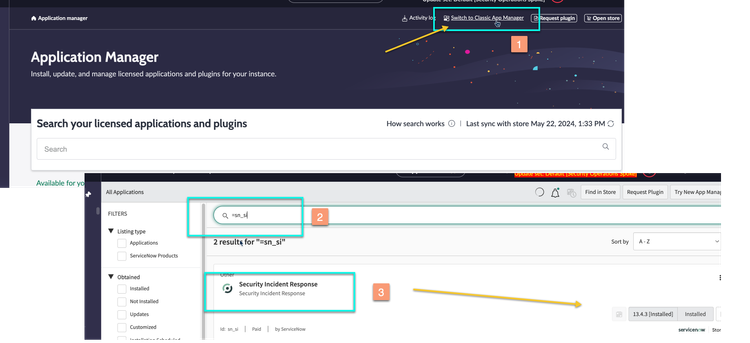

I'm trying to install the latest version of SIR (13.4.3) on my PDI but it's stuck as per the attached screen shot:
V. 13.4.3 has only been in GA for a couple of days, so I'm wondering if that's the problem. Interested to hear from anyone who's been able to successfully install it on a PDI already.

Have also seen an odd experience with this here and using the new Application Manager.
Could you try temporarily switching to the "Classic Application App Manager" - search for the Security Incident Response (sn_si) Application, and attempt the installation that way?
This has seemed to do the trick running into this recently these past few days...
Simon Hendery
Thanks @andy_ojha - your suggestion worked. Appreciate your help!
