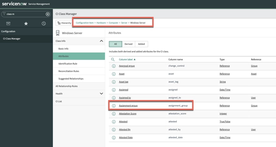

chrismcdevi
Jason,
The Assignment Rules that use the scripted assignment uses "current". So...
//basic assignment
var gid = "cfcbc3720ff55a80f9fb00dce1050e37”; // Identify Assignment Group by
current.assignment_group = gid; //Set the Assignment Group
I'm not sure how your plan would work. Let's look at a Windows Server:
A Windows Server is a Server. A Server is a Computer. A Computer is a Hardware. A Hardware is a Configuration Item.
Each layer extends its fields and the field of its parent to its child. So, the Assignment Group on Windows Server comes from the Configuration Item. There is only one Assignment Group set in the entire relationship. (i.e. The Assignment Group would IS identical when looking at that item regardless of if you look at it from the Configuration Item or Windows Server class)
Go ahead and mark this as helpful or Correct!
