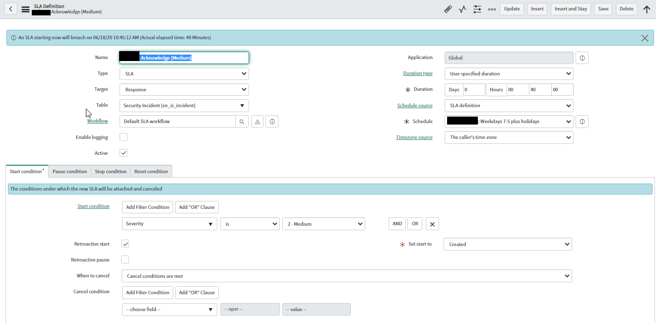

I have created two SLAs setup for Low and Medium Severity. I have an inbound email action to manually set the Severity to 3-Low if the Subject has Low and an email action to set the Medium email subject Severity to 2-Medium. The Security incident that is created from the Medium email has the Severity set to 2-Medium and only the Medium SLA is applied. However when the Security Incident is created for the Low email, the Severity is set to 3-Low but both Medium and Low SLA are applied.If I change the SLA start condition to look at the Subject the correct SLAs are applied; Low only gets the Low SLA and Medium only gets the Medium SLA. I have tried to disable all the Security Incident Calculators Group > Severity and also disabled the Calculate Severity Business rule. Where else would the Severity be manipulated to cause both Low and Medium SLAs to be applied to the Low Security Incident?

I have attached screenshots of the SLA Def Conditions for Ashutosh.
