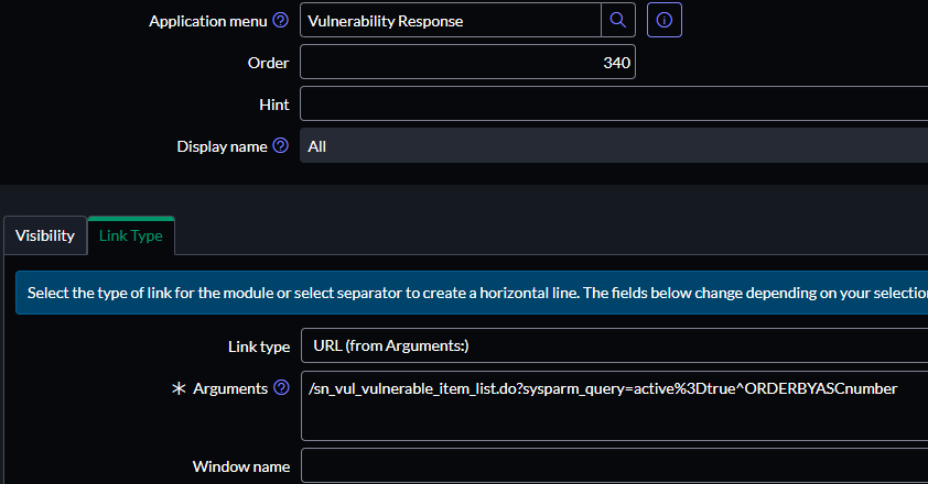

I am attempting to modify a module to load a table sorted by item number in ascending order to enhance performance. Despite setting the link type to URL and configuring the arguments, the module continues to use user preferences to load the vulnerable items table, rather than the arguments that I set. Could someone assist me with this configuration?

Hi @gatesjj2 ,
try this
put this in the arugments
sn_vul_vulnerable_item_list.do?sysparm_query=active=true^ORDERBYnumber

Hi @gatesjj2 ,
I check the similar link and found when we applying ORDERBY with other filter condition, there is no "^" sign for AND condition ( & for AND for filter ) , You can try to create the URL in list view and copy that link in "Link Type" and test.
OR  you can add below sys param for order direction.
&sysparm_order=number&sysparm_order_direction=asc
Example : on Incident table
https://devAAA.service-now.com/incident_list.do?sysparm_query=active%3Dtrue&sysparm_order=number&sysparm_order_direction=asc
