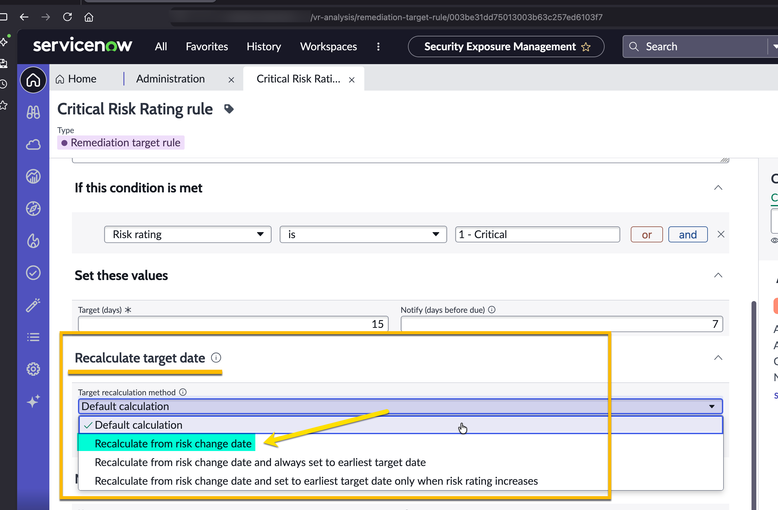

In your Remediation Target Rules -> you can, optionally, setup a recalculation option.
You can change the behaviour, so that the Remediation Target Date on a VIT is re-evaluated, where the clock starts at the time of the Risk Rating being changed.
