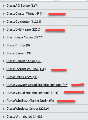

We're having some difficulty with how the Vulnerability Response module chooses CI.
Say our cmdb looks like this:
NameClass
ws-serveraWindows Server
ws-serveraVirtual Machine Instance
ws-serveraStorage Volume
When the VI is created it should match on Windows Server, but instead we're getting a lot of Virtual Machine Instance, DNS Name, and other matches. What's the best/cleanest way to reconcile without loosing historic data?

Also, in some cases, it shows up in sn_sec_cmn_src_ci twice, with the two different CI classes

Thank you, this is helpful. And yes, this is in production
Regarding this:
"Next, you need to know that once an item is "matched" and a record is placed in the Discovered Items module, that match will be used gain. Long story short deletes the incorrect march from the Discovered Items module after using the Ignore CI Class System Property"
>> What happens when I delete the incorrect match from the Discovered Items Module? There are VIT tied to the incorrect match, and I cannot change the CI on those VIT because the VITs are already closed.
Also we cannot delete those records
