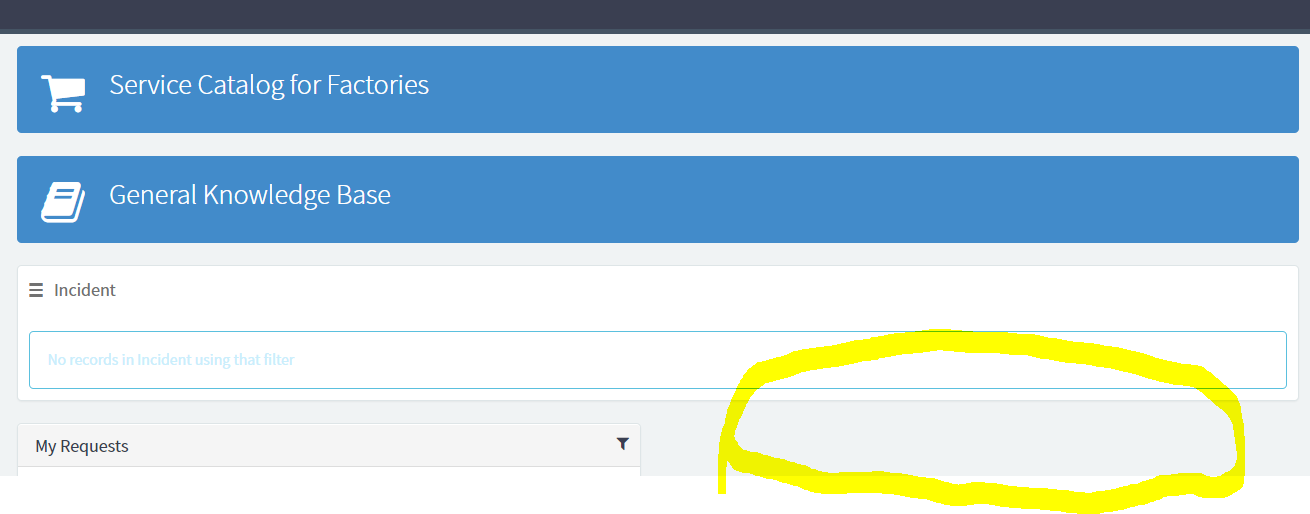

Hi Alberto in My case user can see the approval records on Normal end user front end page not in service portal .
See the below screen shots 1 & 2

I can answer my question as in London upgrade out if widget having roles so best practice is clone the widget and customize the code with roles or with no roles based on your requirement .
