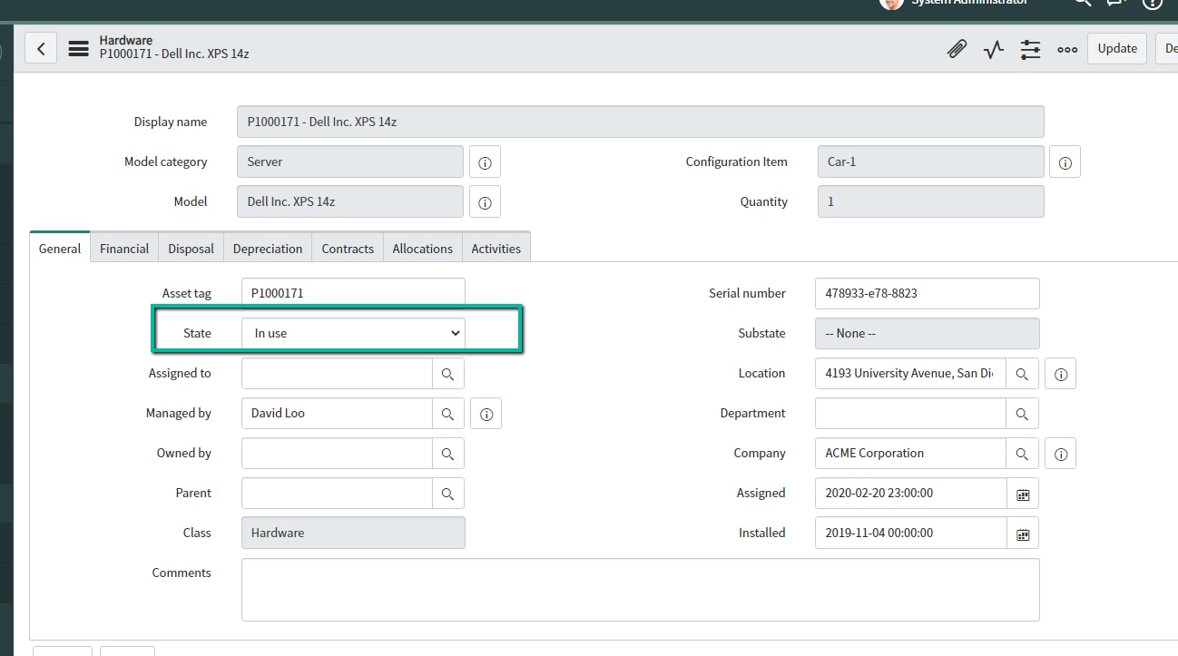

Hello Tim,
Thanks for your response. Here are the details.
CI side changed the Car-1 install status.
But on Asset side it doesn't change. (Still shows in Use)
But when we change it from Asset side, it does reflect change on CI side.
Feel free for additional questions.
Thanks.
