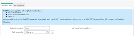

See the following screenshot and link explaining basic authentication:
https://www.debugbear.com/basic-auth-header-generator

Hi @rahulg ,
1. Can you try to give user name password on REST Message Authentication tab?
Create Basic Auth Profile and give user name and password and no need to set on business rule again.
