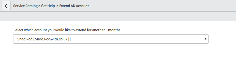

Out sys_user table is populated from AD , however there are a lot of system accounts.
I want to hide these as I am creating a lookup select box available on the service catalogue for managers to select a user and automatically have their accounts in AD extended (this I can do in orchestration and powershell).
The problem I am having is that even though I put a tick next to hidden (a field on the user form) the system accounts are still showing. It used to work - any suggestion how I can filter these out?
have shown a demo with test user I have marked as hidden but they still show in the lookup listfind_real_file.pngfind_real_file.png

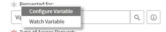

Right click over the variable name, and click on configure variable.
And then go to Reference qual condition under type specification and add your filter

If I do that I only get this view. I tried configuring form layout - to add ref qual condition but they were already there. so I assume its something specific to a lookup select box
add in reference qual box like
u_hidden=false
