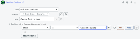

yashkamde
Hello @vikaskumarc ,
After the creation of catalog task you can just add the step "Wait for condition" i.e if the state is closed complete,
complete you RITM and REQ !
Also make ensure that you uncheck wait checkbox so that the flow doesn't stop in in Progress :
