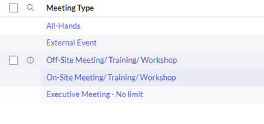

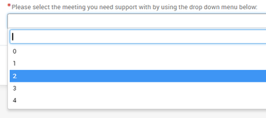

I have created a table 'Meeting Type' with required options. I have given that table as a reference type in the catalog form with 'ref_ac_columns=u_meeting_type' as a variable attribute. But when I try it, it shows the options as 0,1,2,3,4. Why is it so?
How to display the options given in the table instead of those numbers?

The most common reason for seeing that setup is that you have a column in your table that has those numbers and that column is marked as display.  The system uses the column marked as display to pass a value that makes sense to us humans  rather than the sys id when displaying a reference.  Make sure that you have the descriptor that you need showing as display.  ALso make sure that yo uonly have one column marked as display.
Hope that helps.
