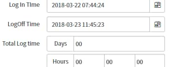

I want to find the difference between the two date time fields and need to update in other duration field
venkataci
Kilo Contributor
I want to find the difference between the two date time fields and need to update in other duration field.
find_real_file.png   Log in Time and Logoff time are Date/ Time fields and Total Log time is duration field.
I have written server side script for this to work calling a glide ajax call. But it is not calculating the difference.
