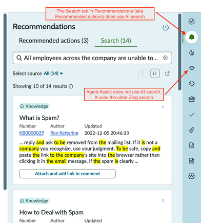

Can you have a look at this screen shot and confirm if you are using the Recommendations tab in SOW (the one that looks like a bell), or the Agent Assist tab in SOW (looks like a graduation cap).
I'm asking as only Recommendations (aka Recommended Actions) supports using AI Search, Agent Assist uses the older Zing search tech so does not support AI Search.
