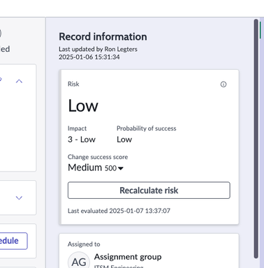

My customer is not using 'Impact' in their Change processes, so they don't want to see it. I've removed the field from all the views of change_request, but it's still showing up on the 'Risk Details' card(?) in the Record Information - Change SNC panel (is it a panel?) on the SNC Record page (and I'm not sure I described that path correctly).
So, the quick question is - how can I hide this?

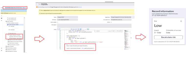

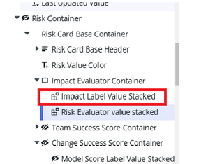

@Ron Legters Based on your use case, I just did some analysis and was able to find out the details requested.
Record Information - Change SNC, holds the components "Impact Label Value Stacked" & "Risk Evaluator Value Stacked" which inturn calls the script include ChangeInfoSNC [read only]. Customizations to be done on the ChangeInfo script include.
Two ways to hide the "Risk" tile,
1. Disable the visibility of the component from UI builder
2. Inactivate the "Risk" card record for the respective or all states from Change Contextual Sidebar Cards table.

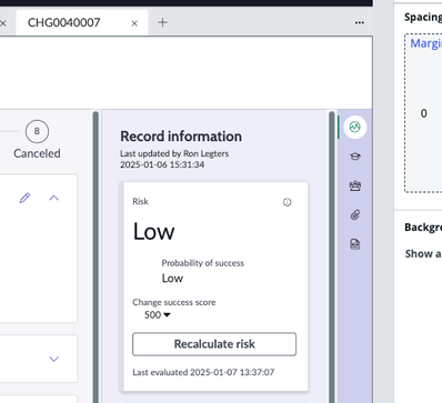

Hi Sujatha - I can't change that value on the OOB sub-page record, but I was able to Duplicate that variant and change it on my duplicate. It looks to be working in UIB, but not in the workspace. I've cleared my browser cache, and did a cache.do, and it still isn't working. Any ideas?
UI Builder:
Workspace:
