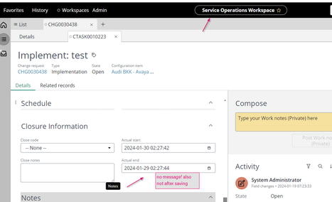

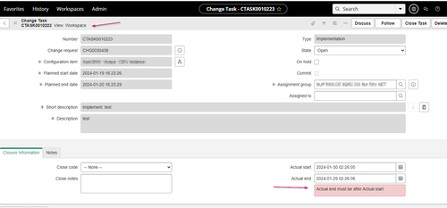

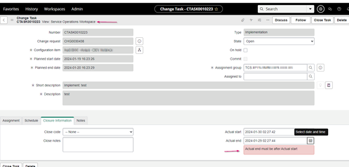

I tried this for change_task table. Additional to (out of the box) existing Client scripts I added the 3 new one for change_task with the same code like the existing for change_request (because the field names are the same).
My problem is, that in classic view everthing looks good, also when I open the view for SOW and Workspace via Classiv view.

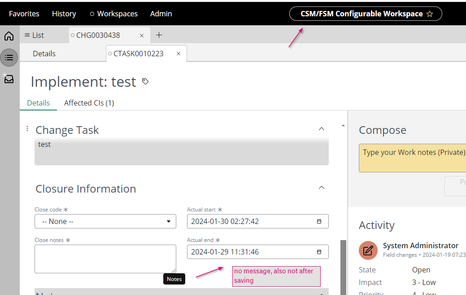

But when I switch to the real SOW and Workspace view, I dont get any messages when my end date is before the start date.

thanks for the info and for your help. I tried it, but in SOW and CSM Workspace nothing happened 😞
I have the following scripts:
UI Script (was OOTB already there). I deleted the old UI Script and created a new one with UI Type "All"
Client Script "Date Validation Load" was OOTB already there. I deleted the old Client Script and created a new one with UI Type "All"
3 Client Scripts which I created new, now with all this points what you mentioned.
"BASActual Start date onChange validation"
"BAS Actual End Date onChange validation"
"BAS Actual Start/End Dates Validation"
Best regards Nicole
