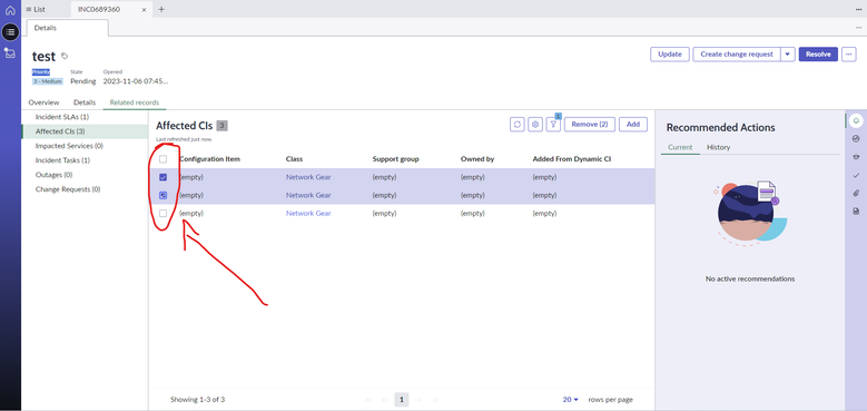

I'm looking to incorporate a select box into the out-of-the-box related list for the relationships between the extended task tables, in order to facilitate the removal of these relationships. I've already created declarative actions for Add and Remove; however, to make the remove function work, I need to enable the ability to select records within the related list, similar to what we have in various out-of-the-box related lists, as shown in the screenshot below:
How can I enable this record selection feature in a related list that doesn't come with this capability by default?

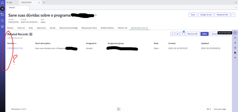

I’ve found the solution. For those who might encounter the same issue, you need to set a specific flag within the declarative action. This can be done in the advanced view settings. The correct configuration is illustrated in the image below:
