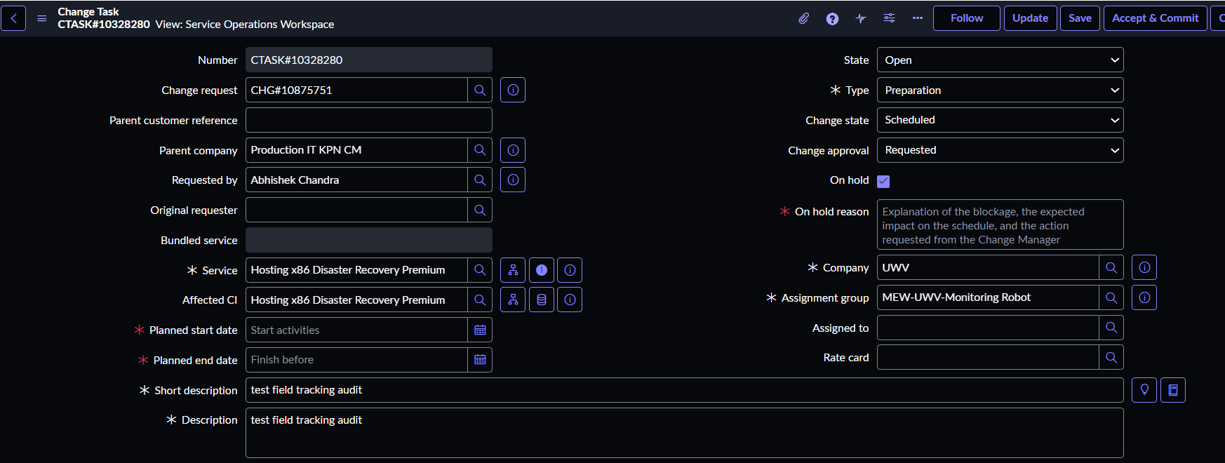

But when i added the ghost text on the SOW workspace , It isn't working for the Planned start and End date as we have a DD:MM:YYYY format placeholder by default and not able to override it , So if it possible to guide us ,What exactly needs to be done for the existing Placeholder to be replaced by the Placeholder provided by the Business and they are in Dutch and English language (Placeholder needs to be according to the User language).
Also for the Work UI it is working when tried via Client script (attached image).
But for SOW it is not working even the view is SOW

how is the client script doing this?
may be that g_form method is not supported for Date fields in SOW
Also check this, seems that placeholder method doesn't work for Date in Workspace
Placeholder Text on Service Operations Workspace
I tried for String field and it worked in SOW
