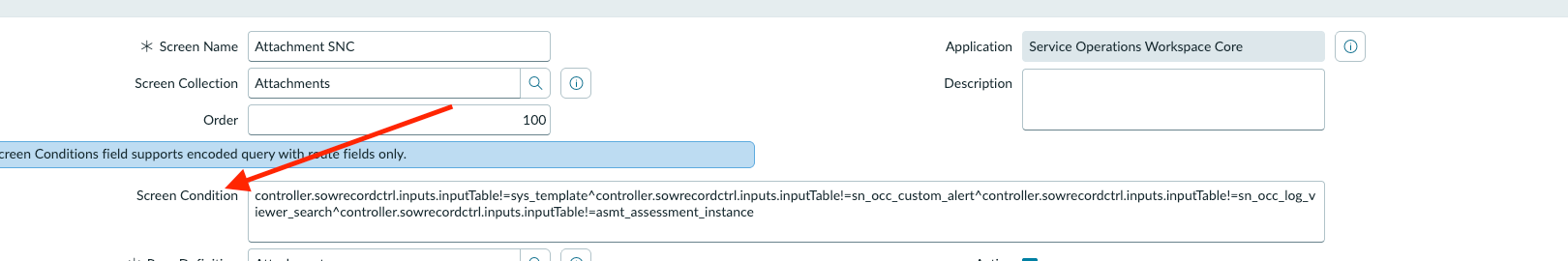

Open the table named as UX Screens (sys_ux_screen) .
In that table, open the record with sys_id as 4bd685bc43b47110cc25ff53e9b8f27c.
In that record you can see the field called Screen Condition as follows
OOB some conditions present in that Screen Condition field that is
controller.sowrecordctrl.inputs.inputTable!=sys_template^controller.sowrecordctrl.inputs.inputTable!=sn_occ_custom_alert^controller.sowrecordctrl.inputs.inputTable!=sn_occ_log_viewer_search^controller.sowrecordctrl.inputs.inputTable!=asmt_assessment_instance
just replace that value with the below value
controller.sowrecordctrl.inputs.inputTable!=sys_template^controller.sowrecordctrl.inputs.inputTable!=sn_occ_custom_alert^controller.sowrecordctrl.inputs.inputTable!=sn_occ_log_viewer_search^controller.sowrecordctrl.inputs.inputTable!=asmt_assessment_instance^controller.sowrecordctrl.inputs.inputTable!=incident^ORcontroller.record.form.fields.assignment_group.value!=287ee6fea9fe198100ada7950d0b1b73
In my above value replace group sys_id your group sys_id and save the form.
Now observe the difference in the Service Operations Workspace.

Thanks @Dinesh Chilaka . It is working
