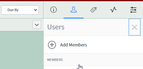

I have created one Visual Task board (Flexible Board) and I can add new Card as owner of the Board, however, other members of the board do not see an option to add the card.
I am sure it must be possible for other board members also to create the card, Can someome help me here?

Hi Deepanshu,
Did you add new members to your freeform board?
If not, you can do it in this way:
Hope this helps!

Can you please share how you created board and how you added users?

What kind of records are you creating with your Visual Task Board? If you are using Data Driven (Flexible) and say, looking at change records, then the users must have the rights to create change records in order for them to create a new card.
If you need a board that anyone can add cards to, you generally need to use the Freeform board option.
