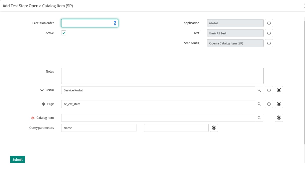

Which ATF test step are you using? If you are using 'Open a Catalog Item (SP)' then it has Query parameters field to supply the parameter.

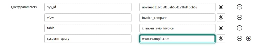

Thanks! This may be the answer, but it still doesn't appear to be working. Even though I set sysparm_query to a value as a Query parameter, the test behaves as if it is blank.
I haven't been able to find any documentation for this. Do you know if there is a way to see the URL that is generated from the test step (or what the URL would look like if it had those parameters)?
As an example, I'm trying to set the sysparm_query value in the URL to www.example.com as in the example below:
https://mysite.service-now.com/nav_to.do?uri=%2Fcom.glideapp.servicecatalog_cat_item_view.do%3Fsysparm_id%3D5551234567810d974edf9bc4bcbed%26sysparm_query%3Dwww.example.com%26

This is how you are setting query parameter?
Also make sure this is right query name & value, because i believe sysparm_query is used to filter data like sysparm_query=id!=007

Yes I entered it that way and verified it is the right query name.
