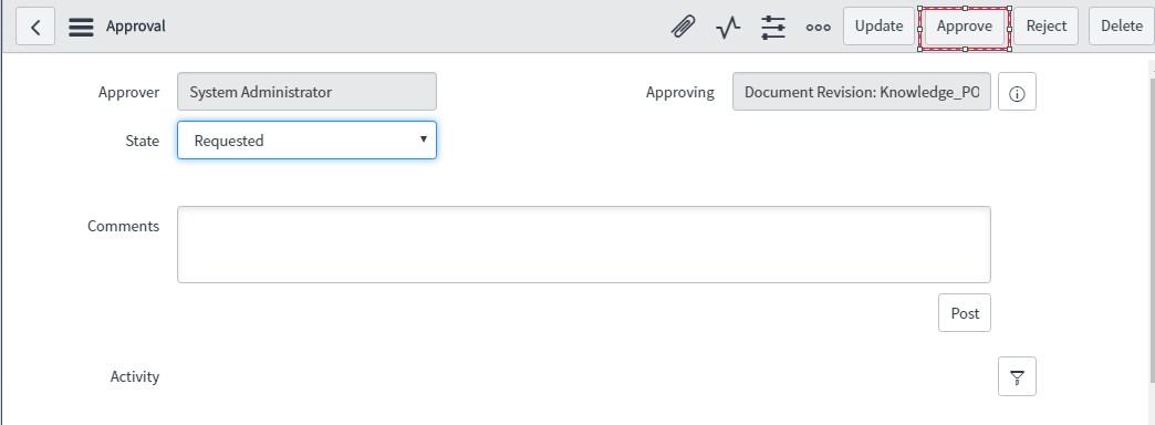

😎 Click on the Approve button as shown below:
