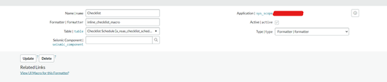

I want to add a checklist formatter to the form view of a custom table in my scoped application. The table does not extend "Task", so I have created a new UI formatter for my custom table (it's created in the application scope). Otherwise it looks the same as the OTB checklist formatter - it uses "inline_checklist_macro".
The checklist formatter is visible on the form, but it does not work - nothing happens when I click on "Create new" or the other options, also the content is corrupted, showing {{template.name}} instead of an actual template:

Hi Cameron,
Can you share a screenshot of your formatter?
