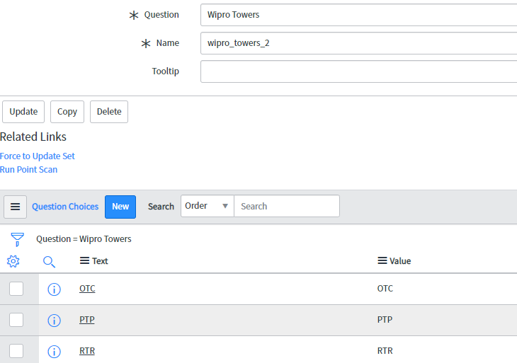

Hello all,
I have multiple choice field, with three choices. The following client script does not seem to work. I want to set a checkbox to true depending on the multiple choice selected on the catalog item,
Type is onchange
return;
if (newValue == 'OTC') {
g_form.setValue('otc_lm_cash', 'true');
else if (newValue == 'RTR') {
g_form.setValue('rtr_icrecon', 'true'); g_form.setValue('rtr_lm_cash', 'true');
else if (newValue == 'PTP') {
g_form.setValue('payment_processing', 'true');
