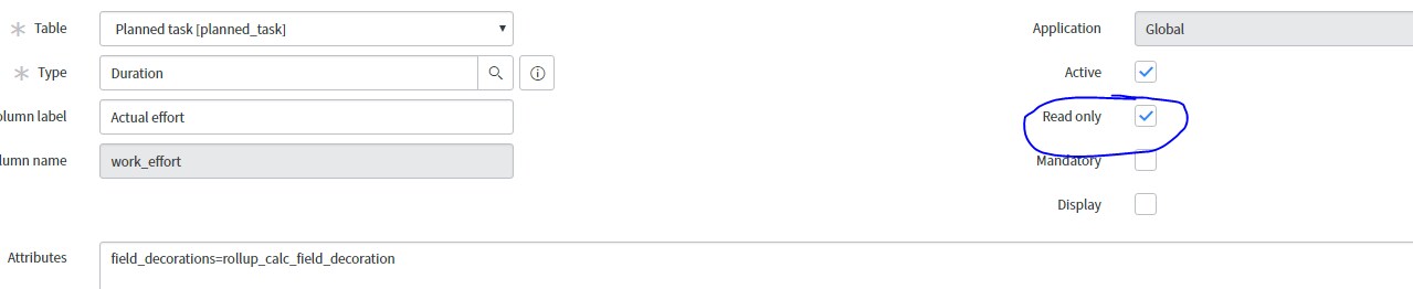

Hi Andrew,
I think i got it,
This is how i see this field in my personal instance
Then I went in the dictionary and checked the read only flag to true
Now I see the field on the form as
Please mark my answer correct/helpful if it helps you solve your issue.
-Anurag
