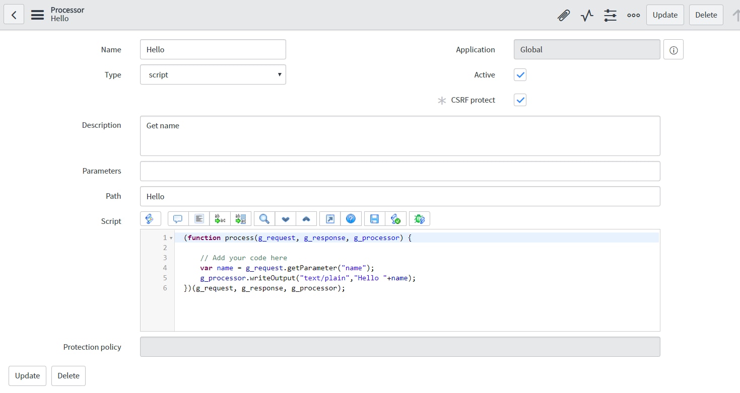

Do anyone know, how to use in CSRF token in processor.
I have created processor & I want to explore *CSRF protect* option.
If I make it active, how it will be called, I am not finding any help in servicenow docs, or any online posts
Here is what I check or tried
1. Checked the sys_properties, it is true
2. Enable it on processor
3. Access it, getting 401, unauthorized
4. Without CSRF enable, its working fine
5. How I can pass CSRF token to the URL, first thing I want to understand where it is set in system & its working.
Any help would be great.
Thanks, in advance.
