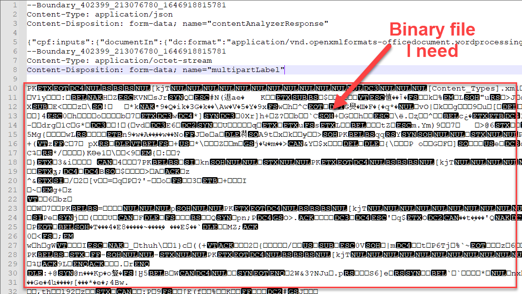

Sending a request with a document template via the REST action step of IntegrationHub to the Adobe API works fine and I get a response as described in the API documentation above. However, the response is in the "multipart/form-data" format and has two boundaries. The second boundary contains the generated document as a binary file.
Here is an example of a response. My goal is to extract the binary file in the second boundary marked in red:
There is a "Save as attachment" option to save a REST response directly as an attachment. And this is actually what I would need, but obviously it will not work if I save the whole response as an attachment, as only the part in the second boundary is the actual attachment. If I use the "Save as attachment" option, download the file, open it with an editor, manually remove everything around the actual attachment and save the file again, I can actually open it and get the DOCX document I want.

  1. Use the "Save as attachment" to save the response, then try to read the contents of the generated document into a string, cut off the stuff I don't want and save it as a new attachment. So basically doing what works if I do it manually by hand (open the file in Notepad++, remove stuff, save it again -> Works). However, it seems to be impossible to get this working directly in the instance. The resulting file is always corrupt as during Binary -> String -> Binary some bits seem to get messed up making the file not a valid DOCX file. I know there is different kinds of encodings, but I tried a lot of different encodings. And while the file almost exactly looks like the file I need, something still seems to get changed/lost along the way. The most accurate result I got was when doing it with the Cp1252 encoding. The files look almost identical, but when I compare them I can see there are minor differences, causing the file to be corrupt and not readable in Word.
