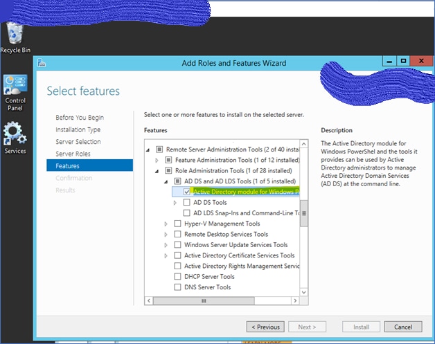

hi Faizan,
I had exactly the same issue last week. We have resolved it by granting/checking the appropriate feature in AD.
See my post for the details : https://community.servicenow.com/community?id=community_article&sys_id=b7079117db1d1c10190dfb2439961...

‎06-16-2020 08:17 AM
Late in responding to this, we're able to rule out which mid servers were failing and throwing this error and the configuration that was not enabled on those mid servers that were throwing error.
As Peter above has also mentioned, we enabled the 'Active Directory' module on each mid server to get this to work and it's been running smoothly since.

hi Faizan,
