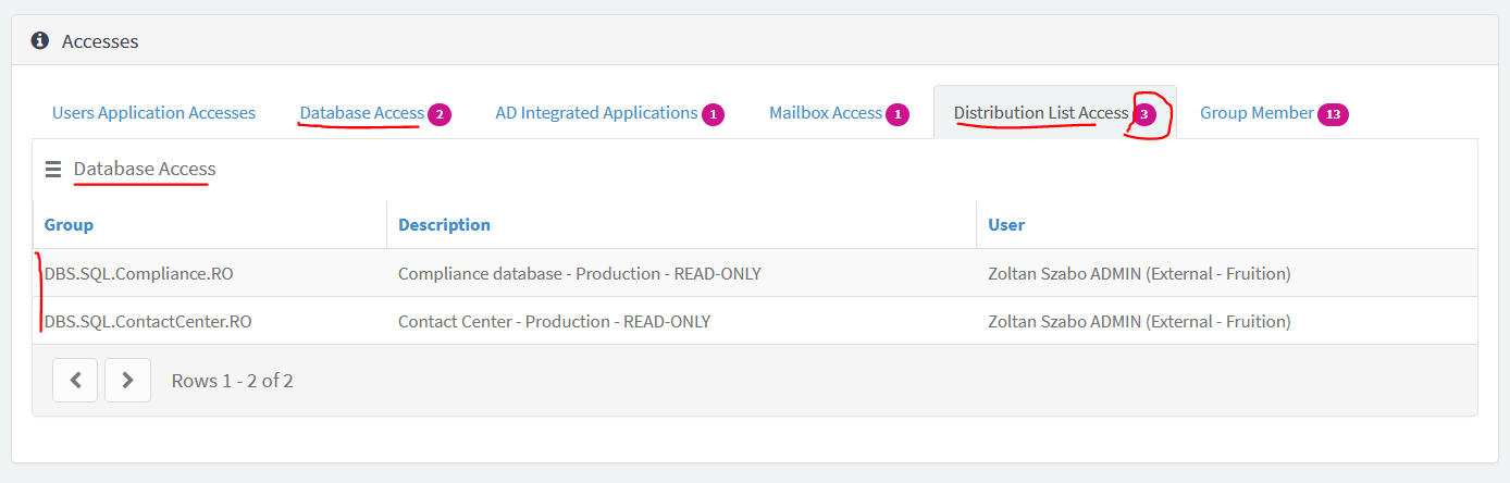

For January we have developed the "Related List" widget, which allows you to display related lists on the form page in Service Portal.
Example below from a service catalog request:

I am unable to get this to work. I am thinking the issue may be from the following:
if (_(data.related_lists).where({"type": "REL"}).length > 0) {
data.related_lists = _(data.related_lists).map(function (item) {
if (item.type === 'REL') {
item.definedRelationshipFilter = extractDefinedRelationshipsQuery(item.apply_to, item.apply_to_sys_id, item.table, item.relationship_id)
return item;
To do this, I added the following snippet of code directly under the snippet I showed above (note that I use underscore - you'll need to have that added in a script include)
If I leave it as is it gives an error related to the underscore "_" being used. You mentioned adding it to a script include. Can you expand on that for me? If I remove it I get no error but the related list displays all the records instead of those queried.

I'm trying to do the same, however I have multiple custom Relationships joining the same tables (User and Group Member) with different queries (group.type=whatever).
Looks like in this case, the first related list of the same table (Group Member) will apply the filter and tab content to all other related lists of the same table 😞
Don't really get it, because the for loop in data.related_lists should pass on the unique filters...
