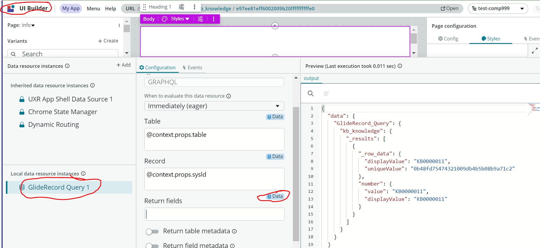

Hi How to add fields on Glide Record Query Data Source in UI Builder Sandiego...?working fine in Rome release...
unable to do it becoz if i click on data binding icon of table its acting on other fields as well below it..in previous release it used to be @ and if we remove it automatically turns to be non binding field but it is not like that in sandiego...is there any way to retrieve fileds with or without data binding friom the knowledge table here?

If I'm understanding you correctly, when you hover over the Return fields property you're not seeing the icon that lets you toggle it back from dynamic data binding to the standard manual selection. I haven't experienced anything like that in a few San Diego instances I've been working in. A couple of things I would try are:
  • Close out of UI Builder completely, clear your browser cache, and open it back up. (I'm assuming you've done this but wanted to mention it)
  • Assuming you're in a subproduction instance or PDI you can run a cache.do on the instance to clear the instance's cache.

Yes it is visile individually but if it is clicked on table level for data binding the table it acts globally and the edit link will be unavailable....in this case I can I retrieve the fields? Please see the screenshot i have shared in the question(highlighted with red)
I have taken new instance,performed cache.do,changed the browser from chrome to mozilla and tried even though it is not working...
If it is working for you kindly share acreen here which helps e a lot.
also i observed that @data.glide_form2.nowformblob. etc,,, is also not working with intellisense as in Rome...how can we make this intellisense work?

Ahh ok I have not run into that before. If it's something that worked in Rome and no longer works in San Diego you'll probably need to contact support.
Thank you @Brad Tilton ...will contact support
