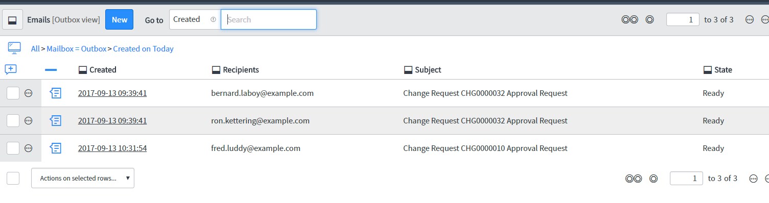

excellent thanks Michael. And one more question...do notifications fire in the developer instance? I know that wouldn't actually send an email, but would notifications that should be sending show up in the System Logs > Email? Just to verify that my chain from scheduled job > event >notification is working.
09-13-2017 02:45 PM
You should be able to see them in the Outbox, if email hasn't been configured.

hum... It seems that your event hasn't been processed. Are you sure your events process is processing events in your instance, or that you schedule job was set to run the job at a later stage, and that time hasn't come ?
