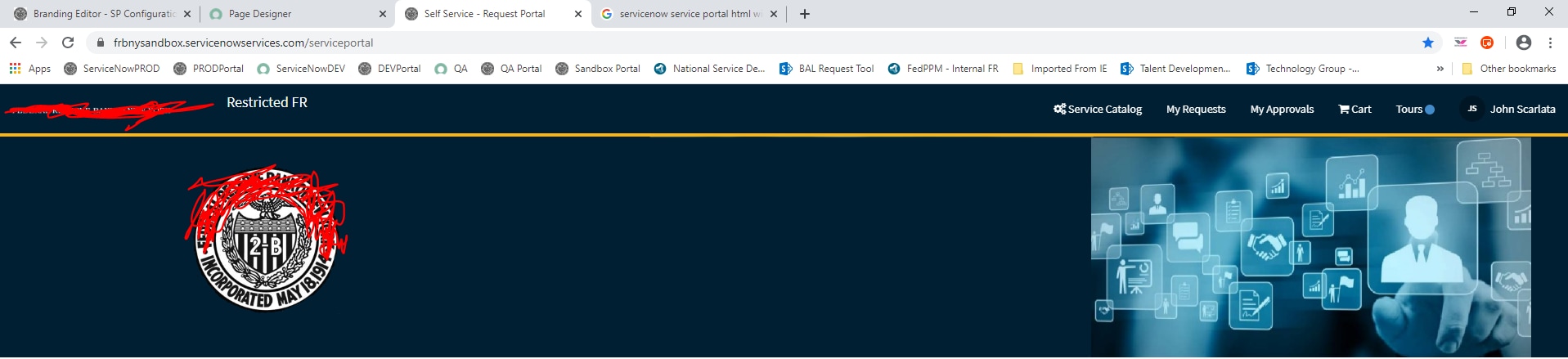

Having trouble with getting a picture to display properly in Portal, when viewed on various sized screens of varying resolutions, the image is pushed and pulled and squished based on the size of the screen/resolution.
i have tried putting the image into the container background, set the width to fluid, and image to either Cover, Contain, or default and i cant get it to work. on a large 4k screen it will get distorted, if i resize the picture to fit, then on smaller screens the image is not showing completely.
I tried using the html widget inside a 12 wide container. this works the best, however the html widget doesnt extend to the edges of the container, leaving blank space on either side of the widget, this space is increased on a bigger/higher res screen.
is there a way to make the html widget extend to the full size of the container edge to edge?
is there a better way to do this?
image 1 - fixed width container, set to Contain, theres spaces on each side, takin on std 1920x1080
image 2 same as above on 4k screen
Image 3 - Fluid, set to COVER, on 4k
Image 4 - Fluid, set to cover, on 1080
you can see how things are moving around...
image 5 - image is in the HTML widget, note spaces on the sides
Image 6 same as 5 but on 4k screen

Hi John,
This is because of bootstrap class as below
You can fix this by adding this CSS to your img tag within the widget
margin-left: -8px;
margin-right: -7px;
