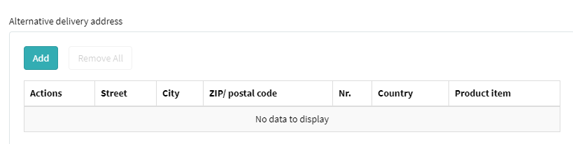

I would like to hide the field on the portal and just leave the add/remove button.
Is it possible?
This is how it looks now, but the client would like to just have the add button.
Thanks!

Thank you for your response. Your answer was helpful to hide the entire variable set. My question refer to hide the fields below the add button and leave just the button.
