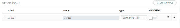

1. Create Action -> Create a new action, then first step is to create an input variable.
Create a payload input variable with type String (Full UTF - 8)(matching sub flow payload data type with custom action input payload data type).

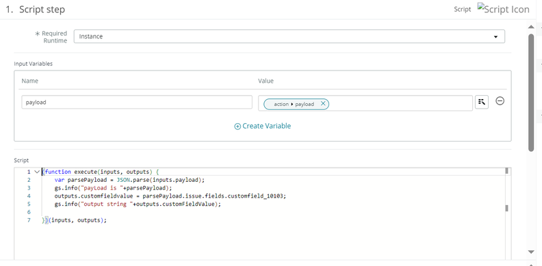

2. Second step is to add a new step and select Script step that executes custom JavaScript. We can also use JSON Parser step to parse the payload data but, it requires some specific Integration Hub plugins installed in order to enabling this step.
var parsePayload = JSON.parse(inputs.payload);
gs.info("payLoad is "+parsePayload);
outputs.customfieldvalue = parsePayload.issue.fields.customfield_10103;
gs.info("output string "+outputs.customFieldValue);
})(inputs, outputs);

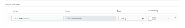

outputs.<variable_name> must match output variable section name.

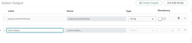

3. Last step is to create Action Output that contains the final result and can be re-used in Subflows and flows.
After creating output variable, exit edit mode and drag-drop output variable from previous script step.

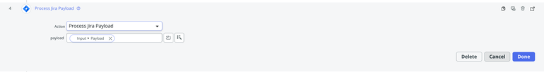

Publish and call this action in your flow or a Subflow provide a payload as an input then the result will be stored in the output variable. Then, use the auto-populated data section output variable to map to your required table field. Please find in below screenshots.

Hi Kiran - I'm trying to get the fixVersions name from the Jira Issue.
I have followed the steps you have provided, can you give more details on how to finish the last step?
Publish and call this in your flow or a Subflow provide a payload as an input then the result will be stored in the output variable. Then, use the auto-populated data section output variable to map to your required table field.

03-04-2024 10:03 AM
I'm sorry, do you have any screenshots to help me with the last step to call the action in the process webhook subflow?
My goal is to get the Fix Versions from the Jira issue to populate in a new field I have created on the task table.
I have followed your steps to create the action, but I'm not getting the new action to work properly in the subflow.
