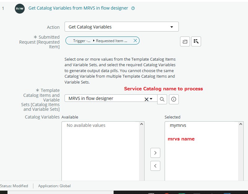

Hitoshi Ozawa
Hi Jacob,
Flow Designer supports mrvs. To get each row, use "For Each Item in"
Example:

Allen Andreas
In Flow Designer, you'd use the same concept of retrieving those catalog variables as normal.
Then, for the MVRS, you'll see that it's an ArrayObject. From there, within the flow, you'd add a For Each Item step to walk through that ArrayObject, you could assign this to flow variables if needed.
Or, if you're sending a notification from the flow, you should be able to use the ArrayObject and write a script yourself to iterate through it, here's an example of a script action you could also use:
var sysID = fd_data.trigger.request_item.sys_id;
var rec = new GlideRecord('sc_req_item');
rec.get(sysID);
var arr = [];
var mrvsVar = rec.variables.name_of_mvrs_variable;
var parser = JSON.parse(mrvsVar);
for(var i=0;i<parser.length;i++){
	arr.push(parser[i].variable_name_within_mvrs.toString());
So a few different options here. I'd recommend trying a bit and then let us know if you get stuck and if so, where at, so we can help further.

Hitoshi Ozawa
Hi Jacob,
Example:
