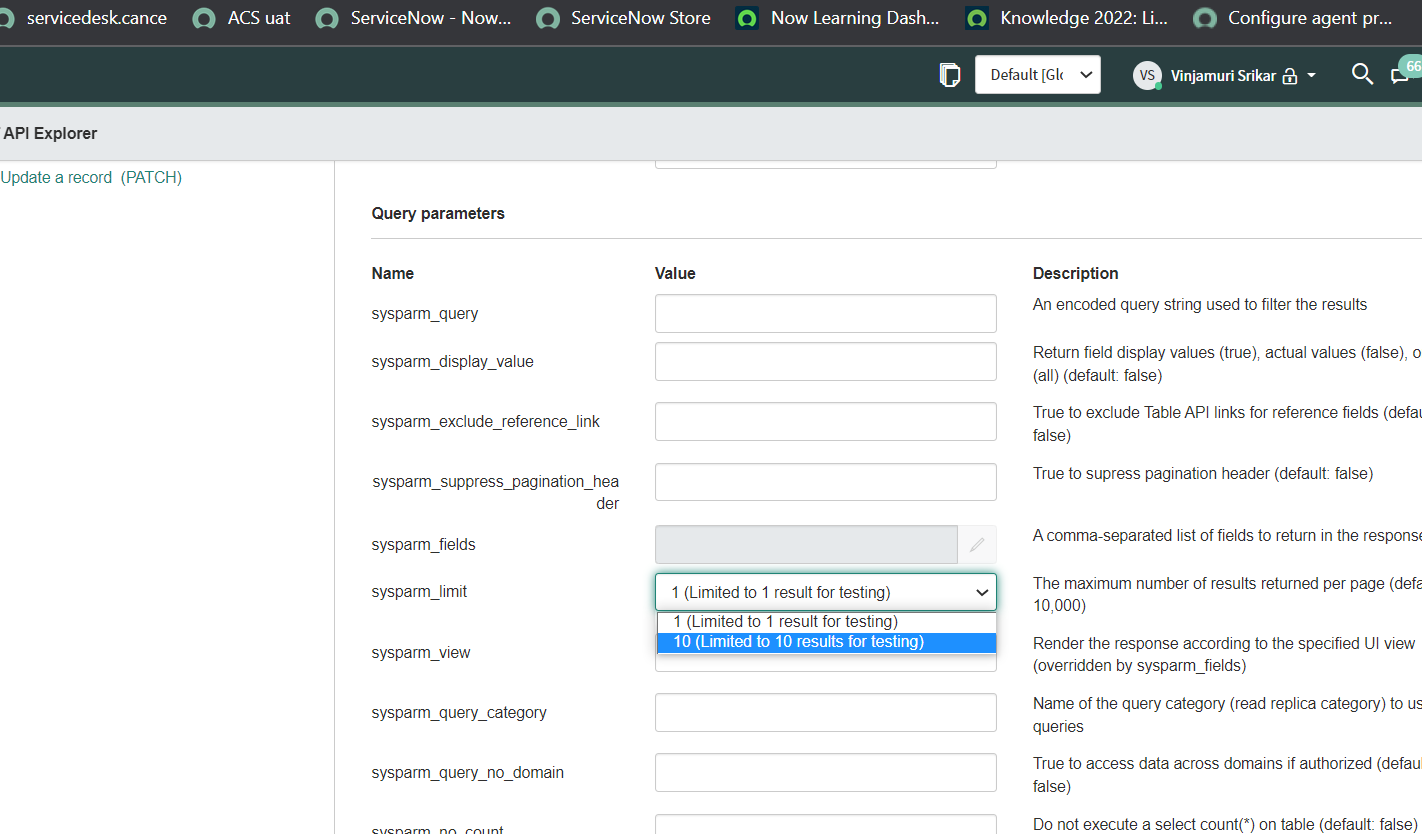

Hi Experts,
                               I am trying get api for one table through REST api and i am unable to extend the sysparm _limit. Attaching the screenshot for your reference. Could you assist me or let me know the process how can i extend the limit of sysparm_limit.

Hello @Atchutaram
I believe you cannot extend the limit in Rest API explorer if you are calling the Rest API via script then you can set the query parameter as shown below:
request.setQueryParameter("sysparm_limit", 100);
Also if you are creating the Rest Message then on the HTTP method (like GET) you can set the query parameter as shown below:
OR in Rest API Explorer once you click on Send request then you will get url for endpoint and you can change the sysparm_limit value in URL and use if wherever you want to use.
